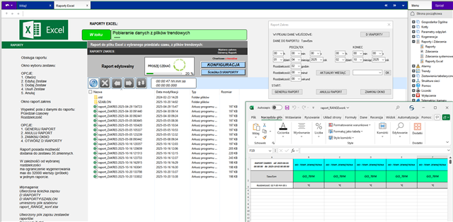

Is there a way to pull data faster using the trendgetable function?
When I call the trendgetable function, it takes a very long time before the function returns data from a longer period, e.g. several months.
For example, if I want to export data from a period of half a year every 2 hours for 5 variables, it takes 8 minutes before the function returns the data.
IF sTagColumn1 <> "!" THEN
ErrSet(1);
TrnGetTable("OBIEKT."+ sTagColumn1, TimestampToTimeInt(t1), Resolution_h ,REP_RANGE/Resolution_h, TrendTable1, 1 + 0 + 12 +0,0);
ErrSet(0);
END
