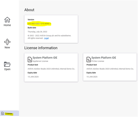

Open the IDE and click on the license tab. (Screen shot belwo)
Refer to the FAQ for various version of the SP.
softwaresupportsp.aveva.com/
Note: If you have applied a hotfix for Application Server, the hotfix might update the CDIVersion to a version not listed in FAQ. The actual installed CDI version can be checked by checking the File Version of <installation drive>:\Program Files (x86)\Common Files\ArchestrA\Framework\Bin\WWCdi.dll.

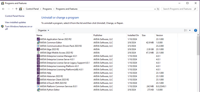

Hi Rafael,
Another quick option is using Control Panel -> Programs -> Programs and Features from Windows.

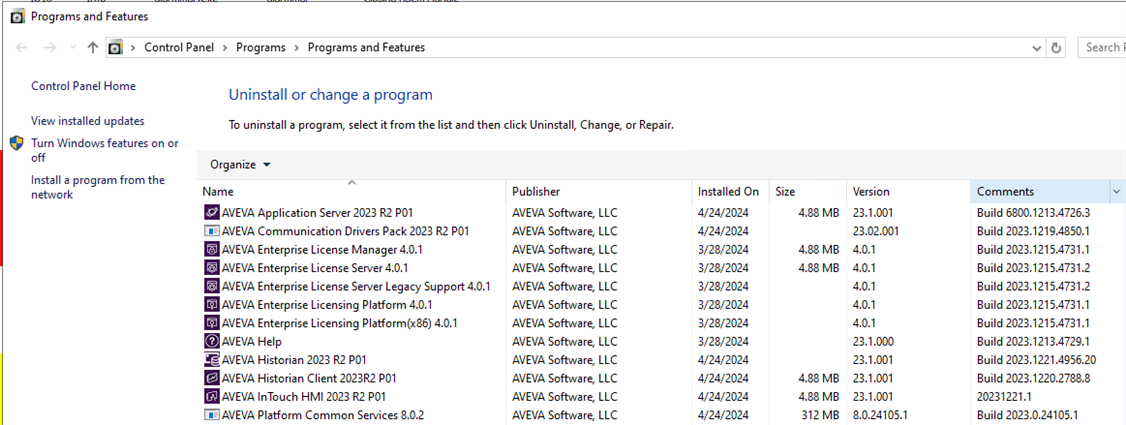

thank you for your help. I guess at the end it was this link that I was looking for.
Enabling comments in the "appwiz.cpl" details can indeed show associated build details for installed applications.
