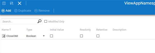

A way that I did is to create a Attribute in your ViewAppNamespace

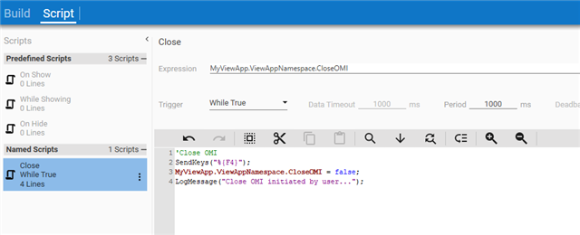

Then set your layout up with a script capturing this and execute the sendkeys command.
'Close OMI
SendKeys("%{F4}");
MyViewApp.ViewAppNamespace.CloseOMI = false;
LogMessage("Close OMI initiated by user...");

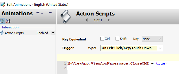

Then you can trigger the Attribute from graphics animation
