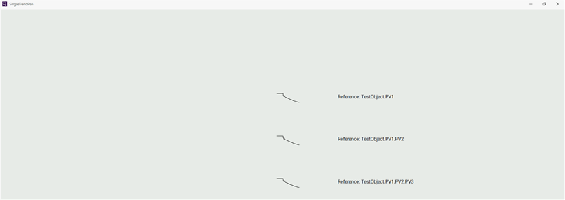

Single TrendPen
When using a application server reference with a attribute name including a period, the trend pen is replacing the part of the attribute name after the period with "tagname". The pen is working, but when the graphic is visualized in OMI its giving a log warning:

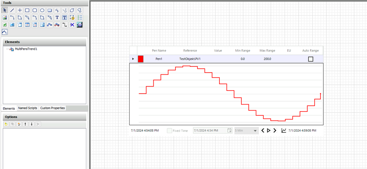

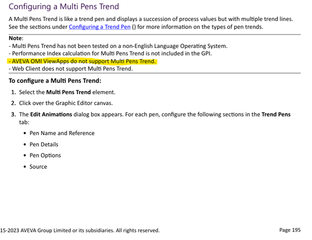

Multi TrendPen
If I create a symbol and embedding a Multi TrendPen in it, when saving/checking in the symbol this message is written in the logger:
If I try to view the symbol in a OMI application there is no sign of it, blank screen and no warnings/errors in the logger.
