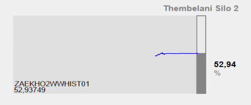

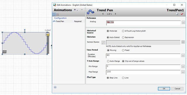

I configured a SA Trend in OMI environment. I configured a Historian source, but in runtime the trend reacts as a realtime trend. I cannot get the Trend to retrieve historical data. I also tried this with the pentrend and got the sam result

Hi Johan,
Thank you for contacting us.
This typically happen:
1. if you didn't configure the actual attribute for historization (remember you also need to configure the Historian source on the AppEngine object hosting that attribute.
2. Historian not running, check the historian status on the OCMC
3. The user that run the OMI does not have permissions to access the data in the historian
Do you see any warning in the logger when you launch the OMI?
Did you trying using Trend Client outside from OMI to see the trend history?
Please share more of the configuration and details
Thank you
