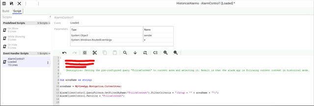

    Thank you for your answer. I managed to get this to work in this way:
    1. Preconfigured the OMI alarm app with a empty query named "FollowContext".
    2. Added a event script in the layout containing the alarm app:

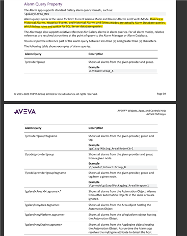

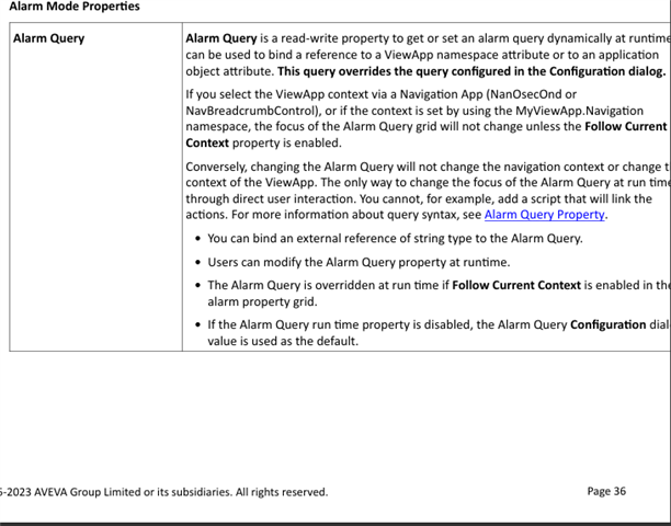

    But shouldn't this be possible to solve by using the "Alarm Query" property in the alarm app?  The "Widgets, Apps and Controls" document indicates that it should, but I can't figure out how the syntax must be in historical mode.

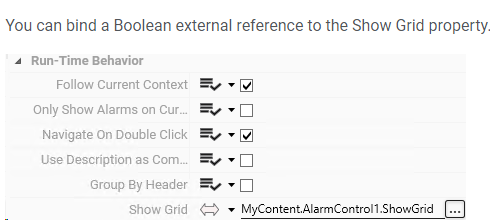

  • You should not need to do much to follow the Context it does it out of the box > just confirm in your OMI page the follow context is ticked where you have added your alarm control.   should be pretty straightforward

    Yes, the "AlarmQuery" attribute only work in mode 1 and 2 ( Current and Recent Alarms). In this case the the alarm app is reading alarms directly from runtime alarm system.
    If you are using the alarm app in mode 3-5 (Historical) the alarm app is reading from your historical source, Historian (History Blocks) in my case.
    You can script the "Follow Context" behavior in historical mode accessing the built in query and filter functions in the alarm app. If you see my answer to IDO further up in this thread, where I explain how I got this to work.
