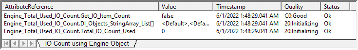

Next attributes will be seen in your ‘Watch List’.
Double click on the 1st Attribute-reference in the Watch List. The popup window: “Modify Boolean Value” appears.
Select the radio button ‘True’ and press the button ‘OK’.
The Galaxy will be scanned, and a result value will be shown for the third Attribute: “Engine_Total_Used_IO_Count.Total_IO_Count_Used”.
This value is your actual used IO-Count of your active Galaxy.

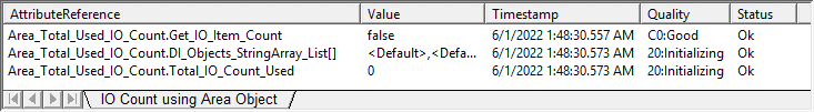

The Galaxy will be scanned, and a result value will be shown for the third Attribute: “Area_Total_Used_IO_Count.Total_IO_Count_Used”.

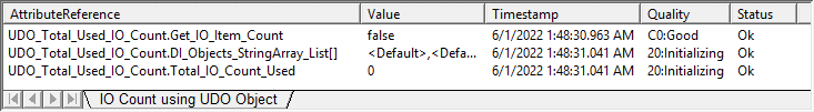

The Galaxy will be scanned, and a result value will be shown for the third Attribute: “UDO_Total_Used_IO_Count.Total_IO_Count_Used”.

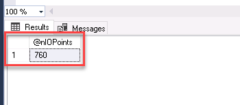

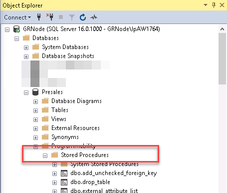

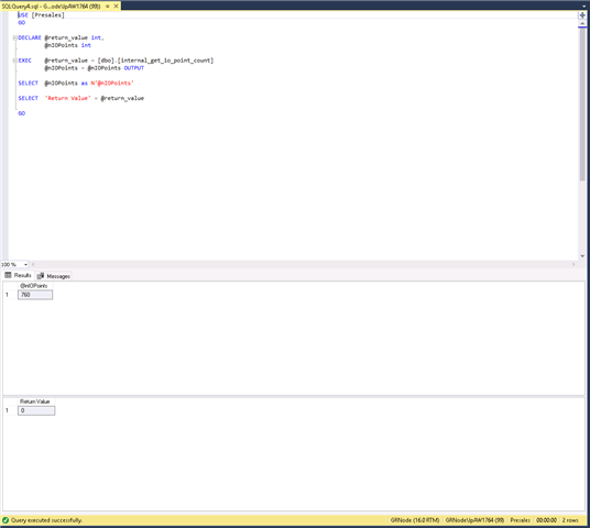

Another method that can be utilized is running a store-procedure within your Galaxy DB.
1. Open Microsoft SQL Server Management Studio, navigate to your Galaxy DB - mine is configured as presales but this unique to your systems and browse to Programmability --> Stored Procedures

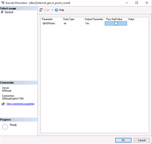

2. Browse to the following dbo.internal_get_io_point_count and right-click and select "Execute Stored Procedure"
3. This screen will pop-up, Select OK
4. A query will populate, select Execute
5. Results will appear below

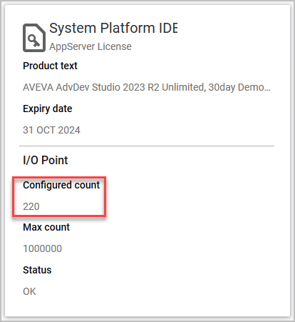

Hi Edward,
This doesn't work if your references are set using scripting instead of hard-coded and or using AutoBinding for your references.
Your result is the same count that can be found under the AppServer License information in the Back Stage of the IDE. See below example:
