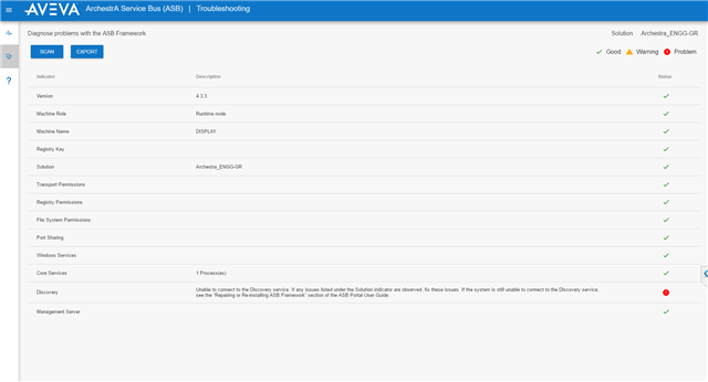

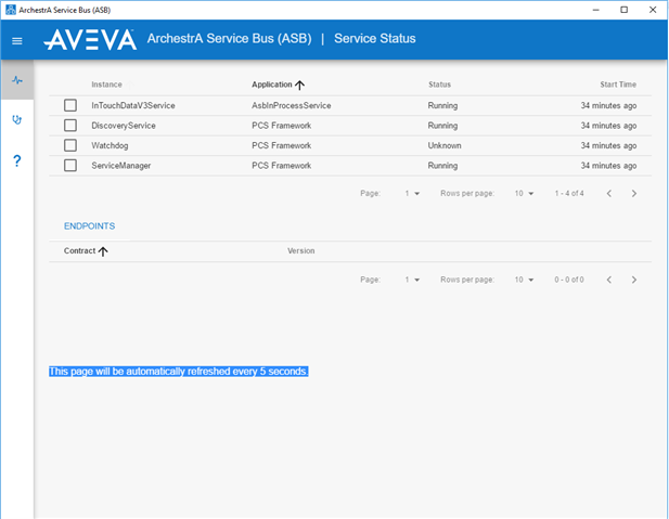

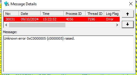

Error on Client Machine When Successfully Deployed from GR . and data not showing on client machine. using aveva system platform 2017 update 3 with sp1.

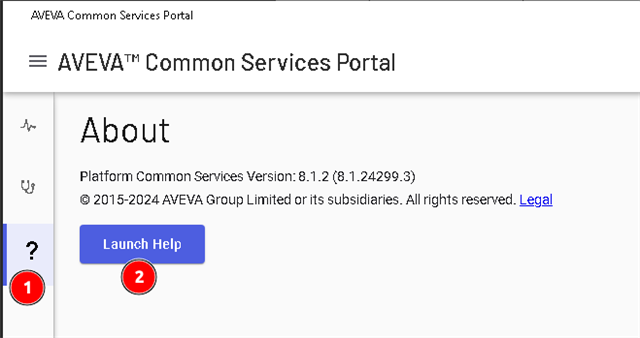

I suggest you follow the suggested steps, in this case "Repair or re-install Platform Common Services". To access the detailed documentation please access the Help section in the Common Services Portal and click on Launch Help:
This will open a PDF containing the detailed steps, hereafter an excerpt:
Repair Platform Common Services
1. From the Windows Control Panel, select Programs>Uninstall a program.
2. Locate AVEVA Platform Common Services in the list of programs.
3. Do one of the following:
a. Right-click and select Change.
Platform Common Service Setup window appears
b. Select Next, and then select Repair.
alternatively,
a. Select Repair.
Re-install Platform Common Services
3. Select Uninstall.
4. Open a command prompt in Admin mode.
5. Navigate to the folder in which the Platform Common Services installer is located.
6. Run the installer - ASBFrameworkInstallx64.msi for x64 OS or ASBFrameworkInstalls86.msi for x86 OS.
IMPORTANT: When repairing or re-installing Platform Common Services, the node on which it is installed is not
reachable.
