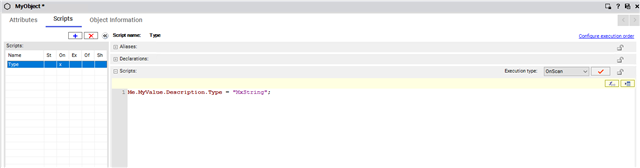

The only workaround we have found so far is to change the Type of the primitive back to MxString, ie in OnScan of the Object.
This will allow for runtime updates from scripts in new versions.
The effect of the Type change is that Initial value is lost (Empty until set script executes), but we can now update the Description
The following will fix the issue of Empty, but it means that Initial value set in design time is discarded.

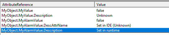

I would expect same applies to any non referenced description, such as .DescAttrName
Here the workaround seem to break down some. and a normal case is that .DescAttrName (Alarm description) is set to Me.MyAttribute.Description
Result is that it will use the design time value, and not update in runtime.

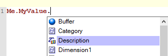

What I'm looking for is a way to set the description in a proper way in runtime.

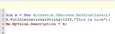

I was trying the following without any success.

  • I think a runtime equivalent of PutInternationalString(lcid, value) will be required but I'm not sure if something like that is available or not.
    Just setting the text like a normal string will not do, since it is quite common to see applications where the server (or the AppEngine credentials to be specific) is running with a different locale than that of the clients, which can cause all kinds of confusion. You probably need to have one line of script to update each locale supported by the specific application. Come to think of it, it could perhaps be useful if one could submit a collection of lcid/text pairs to a method and sett multiple locales in one shot.
    For sure, using GRAccess to set the attribute value will require that you also deploy changes to the affected object which seems contraproductive and using GRAccess in runtime is potentially problematic in terms of messing with default values. Sorry, I know you've heard my rant about runtime GRAccess many times before Smile
  • So the endeavor in setting using the 'correct' datatype failed.
    If the datatype was the issue I would expect to be able to copy one description from another.
     Unfortunately this does not work, so I guess something else is in play here.
