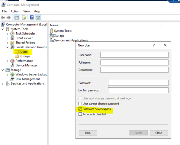

This problem was resolved by creating a local user on Computer management>local users and Groups>Users> New User...as shown below:
To avoid the password to expire, check the box next to Password Never Expires.
I think some additional info from Siyaphila's comments.... once you have that user, run the Change Network Account utility, and put in that users info. You would then need to do this on all of the machines in your system that have the software and are setup to talk to each other. You could also use a domain user, but they still need to be the same for all machines, and if the password changes, you'll need to run the Change Network Account utility on all the machines to update with the new password. Also, running that utility will require a reboot after running it.
