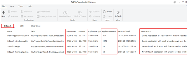

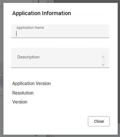

Since no one jumped on this question I will just give my observations on this, as far as I see it it is not possible to edit this by any conventional / known means.
As an observation you can enter data following the below method (the input fields are not read only). But the information is not saved so it seems like a broken feature. So the steps are only to add to the observations, perhaps a ticket with techsupport are in order to resolve this.

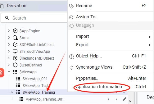

The steps comes from how you edit this on a InTouch Application where it is possible to edit the information

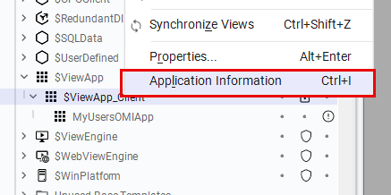

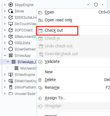

To try this for your OMI application, ensure that you have the Application Template closed. (checked in)
Right click on your application template and select Check out

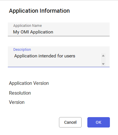

Select Application Information
Now you can edit the Application Name and Description
The thing is is that as mentioned, the information is not saved when closing the dialog box, so the only difference is that the input is not read-only if you manually check the object out first.

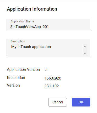

I believe that the rest of the data, application version, resolution and version does not apply to an OMI Application since this information is not available / applicable as compared to InTouch.

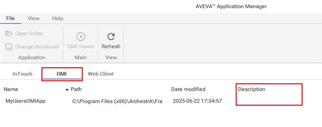

In Application Manager, I would believe this information could be displayed, similar as with a InTouch application.
So as compared with the OMI App Tab
As we can see, only Description is available as compared to the InTouch tab, so my guess is that this 'feature' is not implemented yet.
Still don't know how to edit data that would appear in the description field.
If anyone has some additional insights in this, it will for sure be interesting.
