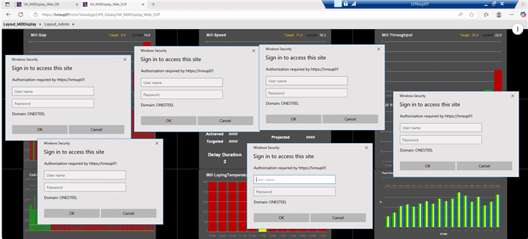

  • https://supervisory/omi -  I get prompt to log in and then I can pick the OMI app I want to view. The view app open and I receive this:
Use the Supervisory as the 'client':
  • graos/omi -  I get prompt to log in and then I can pick the OMI app I want to view. - as expected the view app open and data is active.

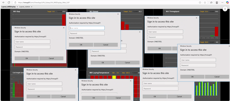

If I provide the credentials again 4 will close immediately and two a bit later.

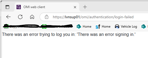

    On the GR(SMS server) we get this message when the client logs in:
    There is no entry in the log on machine that is running the OMI client.
    The user is still in all his corporate groups.
    I have applied the filter, but it doesn't make a difference. I assume this must be done on the SMS server.
