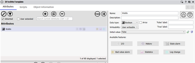

But it seems to contain attributes created on both templates and instances. (it will not list derived objects).

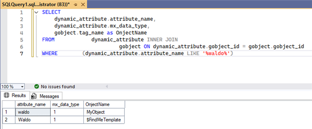

Try the following Query against your galaxy:
SELECT
dynamic_attribute.attribute_name,
dynamic_attribute.mx_data_type,
gobject.tag_name as OnjectName
FROM dynamic_attribute INNER JOIN
gobject ON dynamic_attribute.gobject_id = gobject.gobject_id
WHERE (dynamic_attribute.attribute_name LIKE '%waldo%')
Better extraction of configuration-data from a galaxy has always been high up on my Wishlist, but if you get fluent in GRAccess then you can extract and import information as you please.
I hope it helps.
Richard
