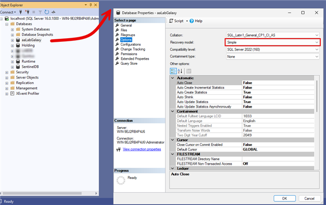

Also in earlier versions of Application Server did the Galaxy database default to FULL recovery model witch also could result in a growing database transaction log (not the database file).
