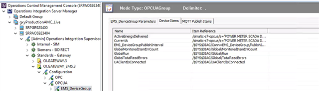

I’m currently working on a setup where I’ve connected to an S7-1500 PLC using OI.Gateway OPC UA. The connection works, I can browse the tags, and I’ve already added them to the Device List.

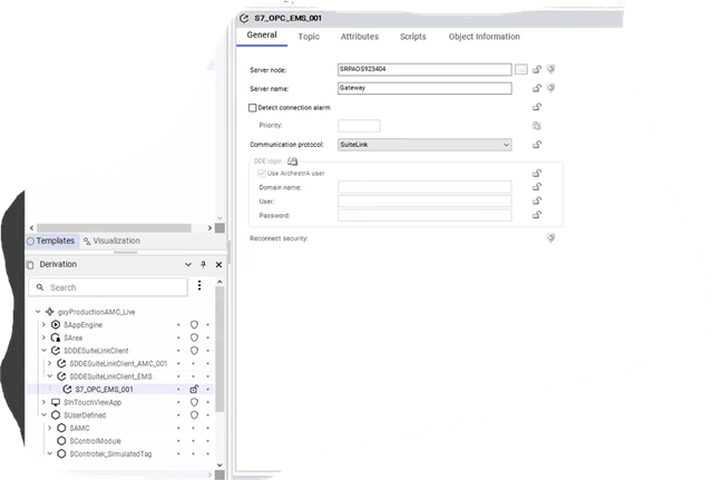

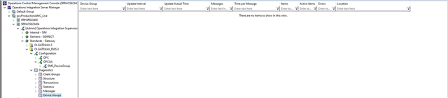

In System Platform 2023, I connected via SuiteLink and was able to browse the tags in Object Viewer. However, the tag quality is showing as bad.Also in OCMC the diagnostic does not show a Device Group and Structure item, it's zero.
May I ask if you have any suggestions or recommended steps to resolve the bad quality issue?

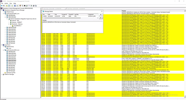

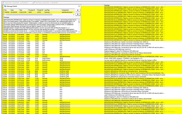

    Have you checked the Log Viewer for additional information?
  • Hello Alena, thank you for responding. Before that , is my set up on OCMC and system platform correct?
    And heres the answer to your question too, yes I check the Log Viewer and try to troubleshoot it but it seems that Im stuck again.
    From what I can see here the OPCUA gateway runs and it successfully connect but fail again and again because the server does not respond.
  • SRPAOS923404.SRPDB923291: Failed to connect to Historian at SRPDB923291:32565 - error = 164 (Communication Error) - Grpc.Core.RpcException: Status(StatusCode="Unavailable", Detail="Error starting gRPC call. HttpRequestException: An error occurred while sending the request. WebException: Unable to connect to the remote server SocketException: A connection attempt failed because the connected party did not properly respond after a period of time, or established connection failed because connected host has failed to respond 10.233.34.194:32565", DebugException="System.Net.Http.HttpRequestException: An error occurred while sending the request.") ---> System.Net.Http.HttpRequestException: An error occurred while sending the request. ---> System.Net.WebException: Unable to connect to the remote server ---> System.Net.Sockets.SocketException: A connection attempt failed because the connected party did not properly respond after a period of time, or established connection failed because connected host has failed to respond 10.233.34.194:32565

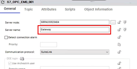

  • Hi Topper
    A thing that caught my eye is that you have multiple instances of your Gateway driver.
    Could you please try and update the Server name on your suitelink connection object to Gateway_EMS
    Redeploy and let us know the result
    Regards
    Richard
  • Thank you Richard , it works now. I greatly appreciate your timely help and thanks to the community.
