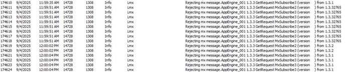

What does the message of “Rejecting mx message.AppEngine_001 1.3.3 GetRequest MxSubscribe3 (version ) from 1.3.1” in aaLogger mean?

The configured galaxy is deployed without any issue. However, the following messages are flooded in Logger on the primary engine node as shown below after set Redundancy.ForceFailoverCmd = true. I rebooted this primary node but it didn’t resolve the issue until I used the failover command again to make this primary node on scan.
Has anyone seen that the message of “Rejecting mx message.AppEngine_001 1.3.3 GetRequest MxSubscribe3 (version ) from 1.3.1” floods aaLogger on the primary node when its backup is on scan before? How could I suppress this message? Thanks.
