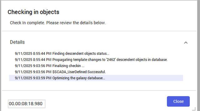

Successful template check in, but derived objects not updated and template still shows checked out after the check in dialog box indicates success
Template check in succeeds, but template is still marked as checked out, and derived objects are not updated with the change I applied before checking the template in. The only change to the template I am trying to check in is renaming an associated graphic (linked content from the visualization toolbox).
