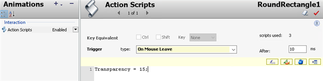

    First of all, turn off Halo, this can be done an results in a more modern feel.
    Use Action Scripts for On Mouse Over and On Mouse Leave to control hover functions (and animations), this gives you a much better feedback on clickable elements.
    Below example uses a simple Transparency solution to provide hover feedback on a rectangle, but the options are many.

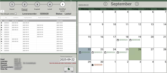

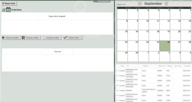

    For Date selection or Calendar, I have actually created a Industrial Graphics alternative, to be able to get a better look and feel, it also enables additional calendar features in some scenarios, not only date selection.
    Sorry for the blurs, but I did not have a good 'lab' example ready.

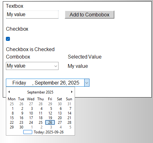

    Some years back we also replaced all user input components with the ones from Microsoft Windows Forms Library, and this is still an option, if you use InTouch, but not an alternative for use with OMI or InTouch Web since .Net User Controls are not supported in the same way.
    But the Winforms controls gave a much better control of input and behavior, but since we try to use OMI in all new projects its not a valid option any longer. And they typically don't scale well in different resolutions.
