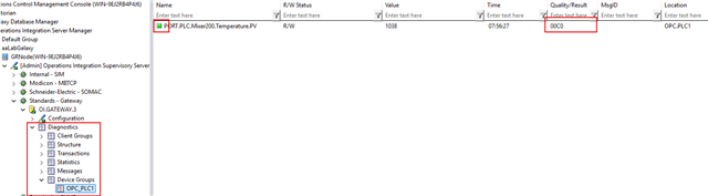

    This then requires a OI Gateway to access a OPC Data source, what is the state of the attributes in the Diagnostics view in OI Gateway? Are they missing in the list, or are they listed with bad quality (red icon) as well?

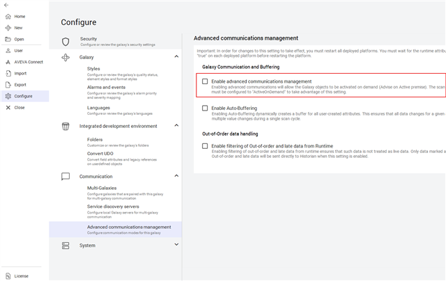

    And as a last comment, please verify the setting for Advanced Communications management, by default it should not be enabled.

    4) Advanced communications management is disabled.
