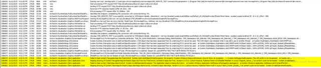

Hi friends, I am experiencing problems with opening an OMI through a browser vie the ITAAS, the error messages are very clear in the log but I am having a hard time understanding what they mean.  The interesting thing is that it only applies to when opening the omi through the borwser but not directly on the node via view.exe any ideas ? attached a extract from the log on the visualisation node

Failed to load content 'NavigationApp.NavTreeControl'
System.Xaml.XamlObjectWriterException: System.Windows.ResourceDictionary.Source threw an exception.
System.NotSupportedException: The URI prefix is not recognized.
3386857  27628  4868   Info   AcfClient
Starting view.exe. ViewApp path: C:\Users\psc-dmro\AppData\Local\Wonderware\OMI_REMOTE_TEST
Command line parameters: C:\Program Files (x86)\ArchestrA\Framework\Bin\ViewAppFramework\view.exe
ViewAppPath:C:\Users\psc-dmro\AppData\Local\Wonderware\OMI_REMOTE_TEST
3386858  27628  4868   Info   view
Start processing HTTP request POST http://localhost:psdiscovery/api/v1/discovery/local
3386859  27628  4868   Info   view
Sending HTTP request POST http://localhost:psdiscovery/api/v1/discovery/local
3386860  27628  4868   Info   view
Received HTTP response headers after 28.32ms - Done
3386861  27628  4868   Info   view
End processing HTTP request after 52.2988ms - 200
3386862  27628  6376   Info   ArchestrA.RuntimeData.PsRuntimeClientDataProxyLib
Initiated the endpoint, establishing the connection with connectionString: HS...
3386863  27628  6376   Info   ArchestrA.RuntimeData.PsRuntimeClientDataProxyLib
ViewApp 'OMI_REMOTE_TEST' successfully connected to 'HsEndpoint'
Details: AbsoluteUri = net.tcp://scadas2.scada.local/ASBService/Default_HS_MxDataProvider/IDataV3
Host name: scadas2.scada.local  IP: 10.4.10.12  Port: 808
3386864  27628  6376   Info   ArchestrA.Visualization.Graphics.MiyViewAppProxy
Starting MiyViewAppProxy : localhost:57501 / ModelProxy/AvevaVisualizationGraphicMyViewAppProxy
3386865  27628  6376   Info   ArchestrA.Visualization.Graphics.MiyViewAppProxy
[ModelProxy-Service] New service started.
ModelProxy-Id: localhost:57501/ModelProxy/AvevaVisualizationGraphicMyViewAppProxy
3386866  27628  6376   Info   view
3386867  27628  6376   Info   view
3386868  27628  6376   Info   view
Received HTTP response headers after 27.36ms - Done
3386869  27628  6376   Info   view
End processing HTTP request after 55.48ms - 200
3386870  27628  6376   Info   ArchestrA.RuntimeData.PsRuntimeClientDataProxyLib
3386871  27628  6376   Info   ArchestrA.RuntimeData.PsRuntimeClientDataProxyLib
3386872  27628  31964  Info   Aveva.Visualization.Graphics.MiyViewAppProxyLib
[MiyViewAppProxy] MyViewAppProxy Subscribe attributes: Test_for_trend.Attribute01
OMI_Namespace.ADAA_BOLA  OMI_Namespace.ADAA_BOLA
3386873–3386876  27628  31964  Info   ArchestrA.GlobalSettings.GDCLListener
System.Runtime.InteropServices.InvalidComObjectException:
COM object that has been separated from its underlying RCW cannot be used.
The COM object was released while still in use on another thread.
   at System.StubHelpers.StubHelpers.GetCOMIPFromRCW(Object objSrc, IntPtr pPCMD, IntPtr ppTarget, Boolean pfNeedsRelease)...
3386877  27628  32136  Info   Aveva.Visualization.Graphics.MiyViewAppProxyLib
[ModelProxy-Service] Service Session of type: MyViewAppProxyModel
SessionId=74a7-6837-a87b-9850a17971fc  id=1
3386878  27628  32136  Info   Aveva.Visualization.Graphics.MiyViewAppProxyLib
[MiyViewAppProxy] MyViewAppProxyModel Subscribe attributes:
OMI_Namespace.Ack_Selected_1
OMI_Namespace.Ack_Selected_2
3386879  27628  32136  Warn   ArchestrA.Visualization.Client.Application.Core
Failed to load content 'NavigationApp.NavTreeControl'.
---> System.NotSupportedException: The URI prefix is not recognized.
   at System.Net...
3386880  27628  34908  Warn   ArchestrA.Visualization.Client.Application.Core
Skipping showing of content 'NavigationApp|ArchestrA.Apps.NavTree',
Version=1.0.0.0, Culture=neutral, PublicKeyToken=23106a86e7060dae
in Layout 'Diagram_Viewer_1' as content could not be loaded.
System.InvalidOperationException...
3386881  27628  34908  Warn   ArchestrA.Visualization.Client.Application.Core
Failed to load content 'AlarmApp.AlarmApp.AlarmControl'.
System.InvalidOperationException: The 'Source' property cannot be set.
Error initializing the element that contains this property.
---> System.Windows.Application.GetResourceOrContentPart(Uri packageUri)...
3386882  27628  34908  Warn   ArchestrA.Visualization.Client.Application.Core
Skipping showing of content 'AlarmApp|ArchestrA.Apps.AlarmApp.AlarmControl',
ArchestrA.Apps.AlarmApp, Version=1.0.0.0, Culture=neutral, PublicKeyToken=null
in Layout 'Alarm_Footer_Double_1' as content could not be loaded.
