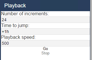

At this point, it's a good idea to set up our interface and test the basic functionality of our tool.
The UI for the tool pane is very simplistic. It has three inputs for each of the options and two buttons for starting and stopping. For each of the inputs, we are using ng-model to bind to the correct option that was created in the input function above. For the buttons, we are using ng-click to bind to the functions we created. This file should be named tool-playback-template.html and saved under the INSTALLATION_FOLDER\Scripts\app\editor\tools\ext directory.

Finally, update the UI to enable or disable each of the inputs and buttons based on the isRunning state.
<div class="c-pane-header t-pane-header-color t-content-font-large t-font-color-white flex-none">Playback</div>
Number of increments: <input type="text" ng-model="options.numberOfIncrements" ng-disabled="isRunning"></input>
Time to jump: <input type="text" ng-model="options.increaseIncrementTime" ng-disabled="isRunning"></input>
Playback speed: <input type="text" ng-model="options.incrementTimer" ng-disabled="isRunning"></input>
<button ng-click="start()" ng-disabled="isRunning">Go</button>
<button ng-click="stop()" ng-disabled="!isRunning">Stop</button>
