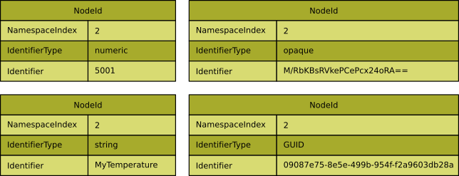

In order to transition from OPC DA to OPC UA, it is important to have a mapping file that relating OPCDA ItemIds and OPCUA NodeIds.
In the old days the classic DA Server have used simple “string”-Identifiers. The so-called “ItemID” was a fully qualified name that was unique throughout the whole server (there was only one “namespace”). Furthermore, the classic DA Servers had only capabilities for a simple hierarchy, i.e. a tree-like structure with branches and leaves. Hence, many vendors have used the full folder hierarchy to create unique ItemIDs (e.g. “Folder1.Folder2.Folder3.MyTemperature”). This lead to massive redundant strings, wasting memory and slowing down performance when looking up or searching for individual Items. With OPC UA, this concept has been abandoned and nodes are uniquely identified by their NodeId.
For existing PI Points, the OPC DA ItemId is stored in the InstrumentTag attribute of the PI Point. For each of those ItemId, one would need to obtain the NodeId on the OPC UA Server. In OPC UA, every entity in the address space is a node. To uniquely identify a Node, each node has a NodeId, which is always composed of three elements:
  • NamespaceIndex
  • IdentifierType
  • Identifier
To define a node, the OPC UA Connector uses the XML notation.
ns=<namespaceIndex>;<identifiertype>=<identifier>

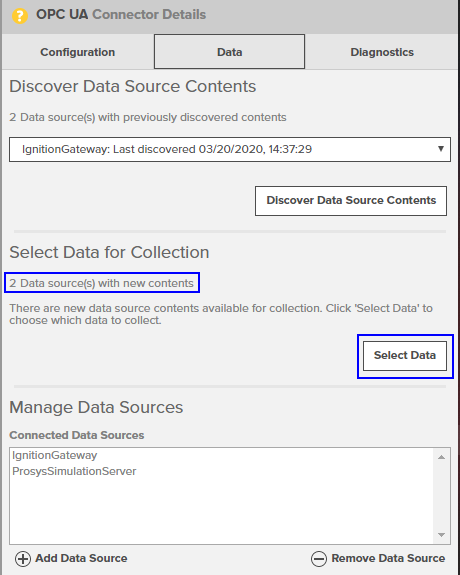

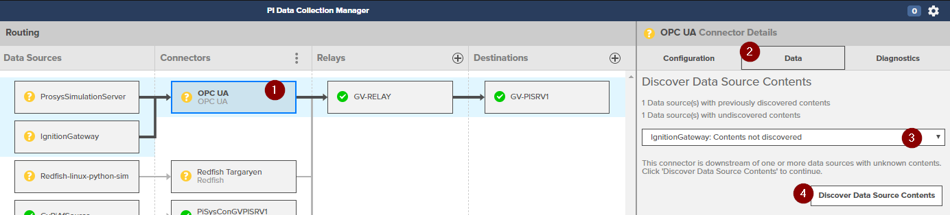

On the DCM, select the OPC UA Connector, then navigate to the Data tab, select the data source, and perform the data source content discovery.
Once data source discovery has completed (can take a long time if the source OPC Server is large), we are ready for the data selection process.

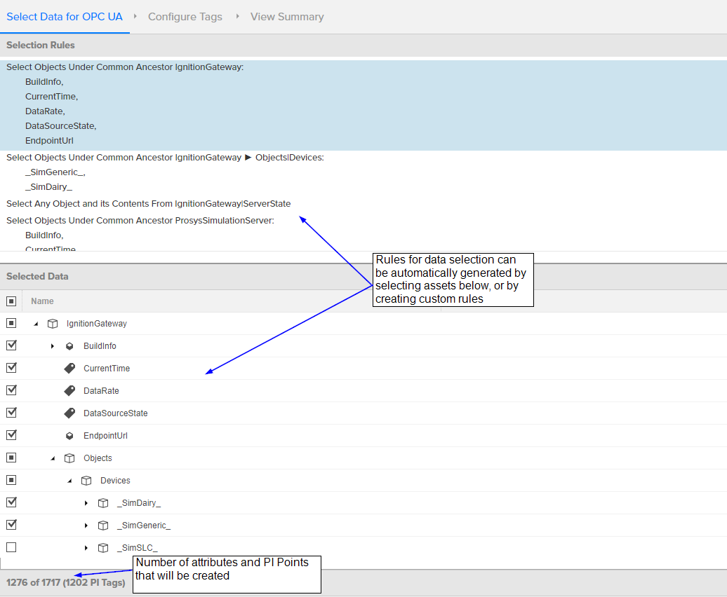

To perform the data selection, one can either manually create rules, or use the data selection UI to select what nodes should be brought in to PI as PI Point / AF objects.

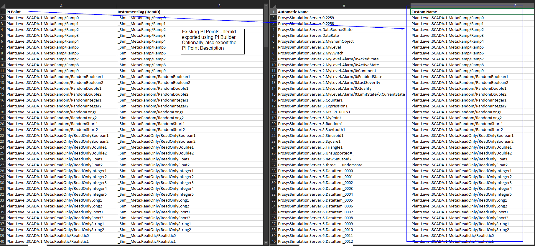

2- OPC UA to existing OPC DA PI Point mapping

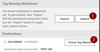

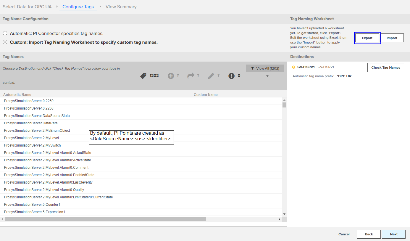

Export the Tag Naming Worksheet
Open the exported spreadsheet and the PI Points with their instrumenttag, and use VLOOKUP to match the new OPC UA Points to their existing OPC DA PI Points (exported with PI Builder)
Save the Tag Naming Worksheet and Import it back to the connector using the Import function and verify that the connector accepts the custom name.

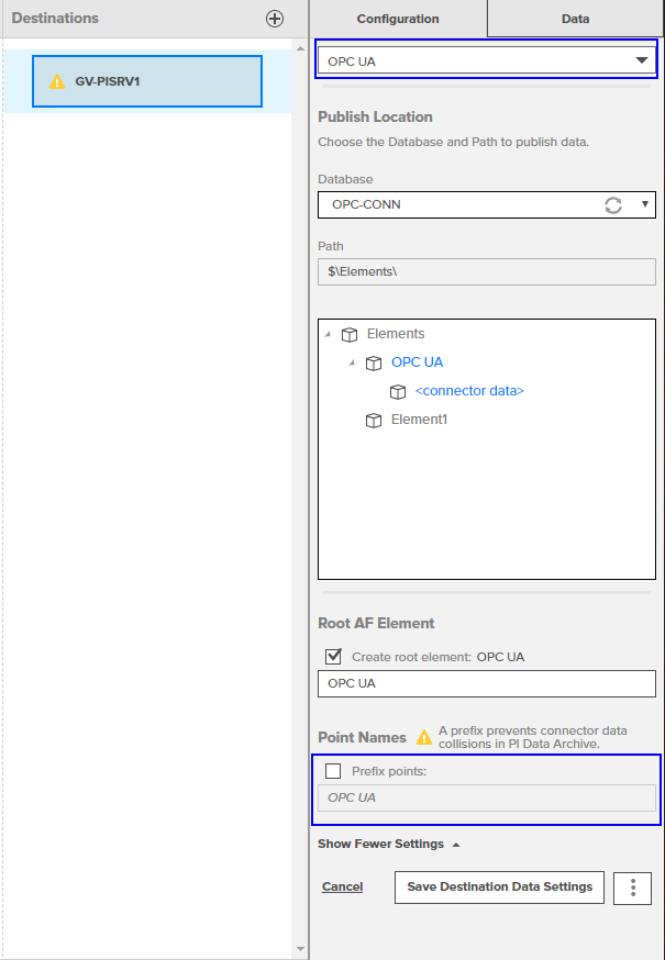

3- Remove PI Point Prefix
In order to match the custom name to the existing opcda PI Points, it will likely be necessary to not use PI Point Prefix on the destination PI Data Archive(s).

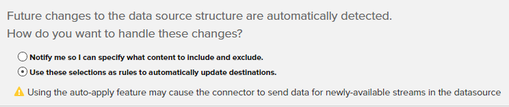

4- Define the behavior for automatically detected model changes on the OPC UA Server
NOTE: Your OPC UA server must implement the GeneralChangeModelEventType so that the connector can react onto these notifications!
See OPC UA - Model Changes and impact on the target PI Server for more details.
