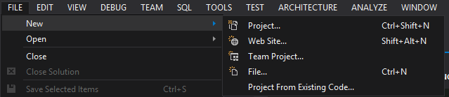

You have more options
a) File --> New --> Project

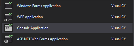

a)We need to choose language of the project. We will be working in the C# so choose C# from the tree on the left.
b) Now we need to choose type of the project. For purpose of this series we will be using Console Application type:

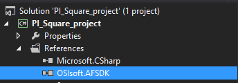

1. You should see tree structure with References item in it.
2. Right click on it and choose Add Reference...
3. Now you need to choose Browse in the tree on the left and then Browse button on the bottom.
4. Browse to the %pihome%\AF\PublicAssemblies\4.0 and choose OSIsoft.AFSDK.dll, hit Add and OK. If your library is already listed in Browse --> Recent, just check the check box next to it and hit OK.
5. Now you should see this library in the References
