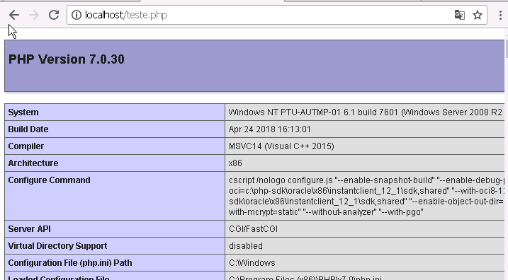

I hope you followed the How to Install and Configure a PHP Website on IIS link above and have a functional website. You don't need anything fancy, just guarantee it is functional by loading a default document. In this case, it may be a simple file named index.php in the root directory of the website, containing the following line of code (Notepad++ may help you a lot):
<?php phpinfo(); ?>
If you are able to see the php information website, when you access your website URL, it is functional. Remember to configure the security, I'm using HTTPS and Kerberos Authentication.

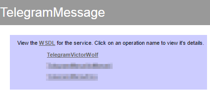

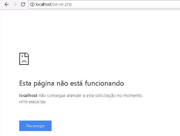

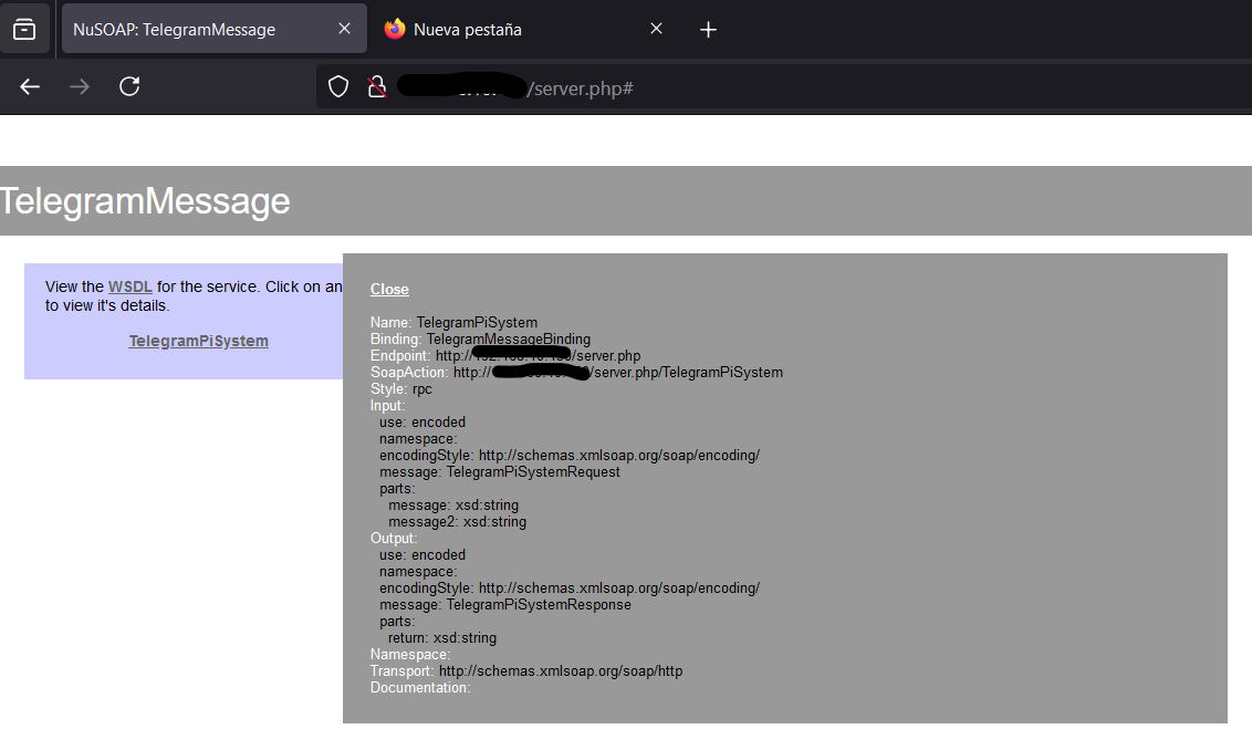

To check if it is working, access your website (ending in /server.php) and you should get something like this:

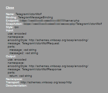

If you click the function name, in my case TelegramVictorWolf, you should see something like this:

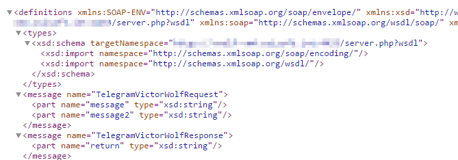

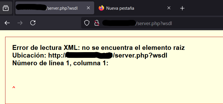

And clicking on WSDL should give something like this:

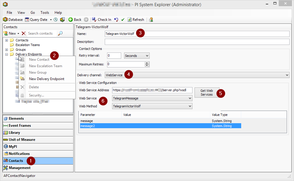

STEP 3 - Configure a contact on PI System Explorer
Now it's the easy part!
Just follow the steps:
- Open your PI System Explorer and go to the Contacts tab.
- Right click "Delivery Endpoints" and choose "New Delivery Endpoint".
- Choose a name for your Delivery Endpoint.
- In the Delivery Channel drop-down list, choose "WebService".
- Fill in your Web Service Address and click on "Get Web Services". This should fill the drop-down lists below.
- Choose the correct Web Service and Web Method and Check In!

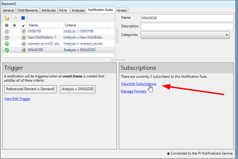

I'm assuming you already have a functioning notification rule, sending an email. If you do not, check out this playlist on our YouTube OSIsoftLearning Channel!

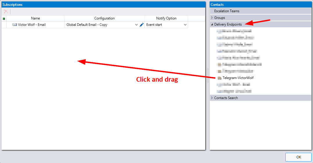

Go to your notification rule and click on View/Edit Subscriptions.
You'll find your contact under "Delivery Endpoints". Just click and drag to the Subscriptions area!

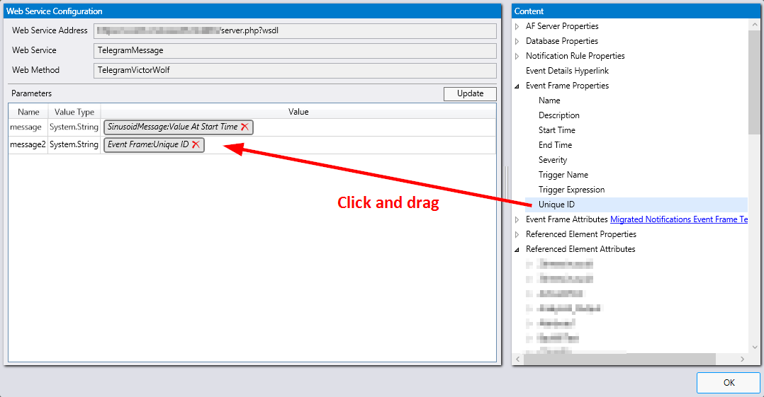

Now you need to configure it. Click on the little wrench:

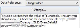

In our case, there will be two messages available, concatenated in the server code. I used a String Builder Attribute on the first one and the Event Frame ID on the second, so I can build the exact message I want to deliver.
If you are curious on how I configured the String Builder attribute:
Web Service Configuration:
Click OK, then OK again. Check in and that's it! Make sure your notification rule is started.

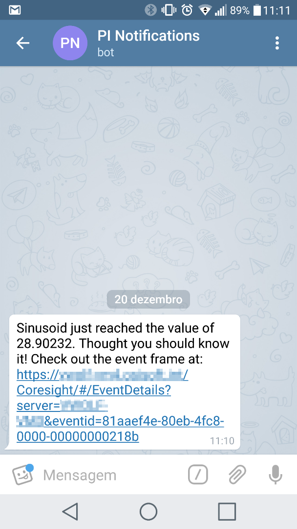

Oh, look! I just received a message!

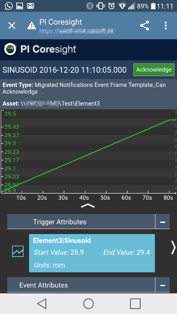

Now I can click on the link and access PI Coresight, to see or Acknowledge the Event Frame:
