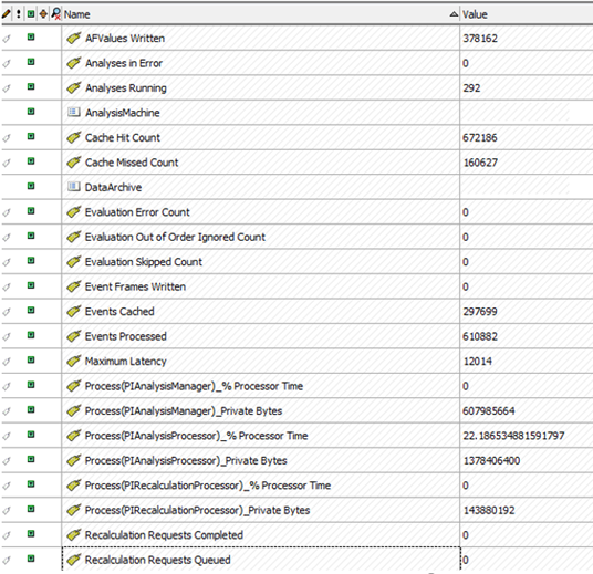

  • Analysis Service Statistics – PI Analysis Service exposes detailed service statistics in the Management plugin in PI System Explorer. Select Management from the navigation pane (on the left) and once in the Management UI, right click anywhere under Pending Operations and select View Analysis Service Statistics. Make sure that the PI Analysis Service is running and that the PI System Explorer is able to connect to the service.

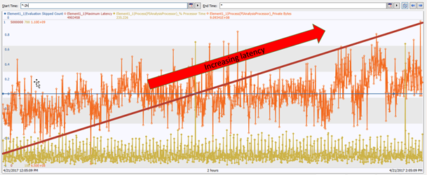

After running the PI Analysis Service for a few hours, notice from the trend below, that the maximum latency value keeps on increasing and the current value is around 4903 seconds (maximum latency performance counter reports the value in milliseconds).
So, what is this maximum latency anyways?
Maximum latency is the maximum value among the latest latency values reported for all analyses. Latency is calculated as the amount of time (in milliseconds) from receiving a trigger event to executing and publishing the analysis results for that trigger event. Large and growing number of maximum latency is a common symptom of performance issues. This value also includes the time that PI Analysis Service waits before evaluating calculations in order to make sure that data for all inputs is available. This wait time can be configured by editing the parameter CalculationWaitTimeInSeconds. The default value for this parameter is 5 seconds. For more information, see PI System Explorer topic Analysis service configuration (or latest version).
Note that this is the maximum among the latest value reported for all analyses. This means that it is possible that most analyses in our system are working fine (i.e. producing timely results), and maybe only a few analyses are causing the system to be unstable.

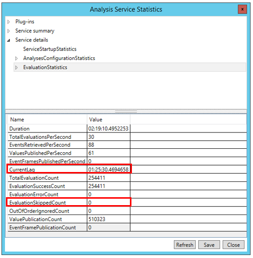

  • From the Management plugin, we bring up the Analysis Service Statistics window.
  • Then we navigate to the EvaluationStatistics node. In the bottom pane, you can see system level statistics, which is very useful in getting a good idea about the overall scale of this system – in terms of the data I/O rate and calculation throughput. In addition to these, we have following two important metrics:
    • CurrentLag: If this duration is high and keeps on increasing with time, this usually indicates that the PI Analysis Service in not able to keep up and is falling behind. If that’s the case, you would want to dig deeper to find out which analyses are causing this. In this case, we clearly have a high lag (1 hour 25 minutes).
    • EvaluationSkippedCount: If this number is non-zero, it implies that PI Analysis Service has skipped some evaluations. We can look at statistics for individual groups to see which groups have skipped evaluations. Note: PI Analysis Service skips evaluations when necessary if the parameter IsLoadSheddingEnabled is set to true (enabled by default).

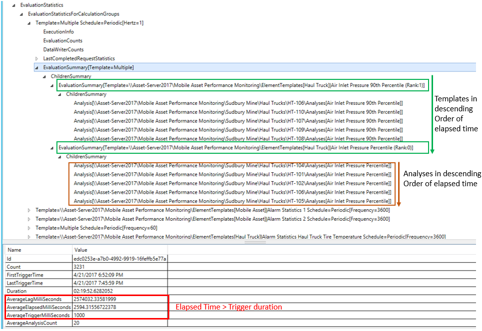

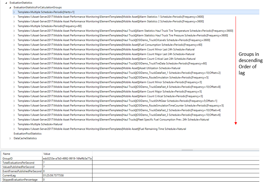

  • Following this, we expand the EvaluationStatistics node and navigate to the EvaluationStatisticsForGroups node, which lists statistics for each calculation group that has triggered at least once. The groups are listed in descending order of lag. Recall that I described earlier how the calculation engine evaluates analyses in groups, so this should not be a surprise that the evaluation statistics are also reported per group. As you navigate the statistics for each group, you would note that:
    • Most group nodes are listed in the format: Template=[analysis template path] Schedule=[schedule for the analysis template].
    • Some groups are listed in the format 'Template=Multiple Schedule=[schedule]'. These groups represent analyses that have dependencies – i.e. the output of one analysis is used as an input for some other analysis. You can think of these special groups as – group of groups, consisting of groups of analyses that may come from different analysis templates, but all share the same schedule. All analyses belonging to this group are evaluate together (for a specific trigger event), such that analyses from templates that are higher in the dependency graph are evaluated first, followed by analyses that depend on them, and so on. Once the entire group is evaluated for a specific trigger event, the calculation engine moves on to evaluating the next trigger event.
  • In this example, the group with title Template=Multiple Schedule=Periodic[Hertz=1] has a very high lag (1 hour 25 minutes), while all other groups have lag < 12 seconds (not visible in the picture, but trust me it’s true) - which is reasonable (keeping in mind that this value includes the default wait time of 5 seconds). From this observation, we know immediately that analyses that belong to the group [Template=Multiple Schedule\Periodic[Hertz=1]] are the ones that are causing the high latency issue.

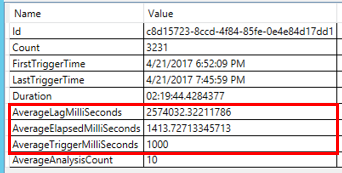

  • We can get more information about any group, by expanding the corresponding node. In this case, we expand the Template=Multiple Schedule=Periodic[Hertz=1] node and select the EvaluationSummary[Template=Multiple] node, which shows useful information for this specific group (in the bottom pane). Note that these statistics have been computed since the service was started (2 hours 19 minutes in this case, as shown by the Duration property). We have following information available:

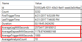

    • Count: Number of times this group has evaluated
    • FirstTriggerTime: First trigger time evaluated
    • LastTriggerTime: Latest trigger time evaluated
    • AverageLagMilliSeconds: Average lag in milliseconds since service started
    • AverageElapsedMilliSeconds: Average amount of time spent (in milliseconds) in evaluating this group since service started
    • AverageTriggerMilliSeconds: Average time between two triggering events. We already know this value for analyses with periodic schedule (e.g. 1000 ms for analyses scheduled to trigger every second), but could be interesting to note for event-triggered analyses.
    • AverageAnalysisCount: Average number of analyses evaluated for the same trigger event. This would be same as the number of analyses from the template(s) for periodic schedule. But it could be different for event-triggered analyses since not all analyses may trigger at the same time.
In this case, we can see that the group triggers every 1000 ms, but takes ~2594 ms to evaluate on an average. This is obviously a problem.
  • For the groups with dependencies (Template=Multiple), the ChildrenSummary node further lists information about each template, in the descending order to average elapsed time. In this case, we have two analysis templates, that each trigger every 1000 ms, but take about 1413 ms and 1178 ms respectively.
    • Template: Air Inlet Pressure 90th Percentile
    • Template: Air Inlet Pressure Percentile
  • For each analysis template, we also show evaluation statistics for 5 most expensive analyses (ordered by average elapsed time), which can be valuable in finding worst performing analyses in that group.

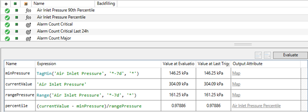

  • Now that we know the two analysis templates that are responsible for high lag, we can look at their configuration to see what they are doing. In this case, as you would have guessed, these happen to be the ones that I had created at the beginning to cause high latency. We don’t really need to understand the calculation logic here, but knowing the fact that they are performing expensive 7-day summary (on 10 second input data), and are scheduled to evaluate every second. This is obviously a bit too aggressive for a weekly summary, and in most cases, would be the result of a misconfiguration.

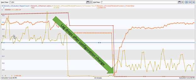

  • Just for the sake of completeness, I changed the schedule for these analyses (based on the numbers above), from triggering every second to triggering every 10 seconds (still aggressive), based on the observation that the group was taking about 2.5 seconds (on an average) to evaluate. As expected, this promptly solved the high latency issue - as shown by the drop in maximum latency following configuration change.
