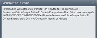

Hi Guys,
I have changed the name of an attribute, after replacing the attribute on the PI Vision screen, this error occurs to me, would someone know what is happening and how I can solve it.
Thanks in advance
Hi Guys,
Thanks in advance
The WebID is built from the path including AF server name, AF database name, element name(s), attribute name(s). If you change any of these, the WebID will change. If you are maintaining a cache of WebIDs, you should set up some regular maintenance task(s) to update the cache.
