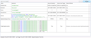

  • Analysis Setup: I have an analysis configured with the following expressions:
It used to be a single analysis but I divided in two for troubleshooting purposes.
  • Execution Frequency: The first analysis is set to execute every minute and the second is event-triggered.
  • Expected Behavior: The AvisoTiempoCambio attribute should change its value based on the FlagTiempoExcedido condition – it should be 2 when FlagTiempoExcedido is True and 1 when it's False.
  • Current Issue: Despite FlagTiempoExcedido being set to True, the AvisoTiempoCambio attribute is not updating to 2 and remains at 1 even when evaluating shows the correct value.

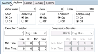

  • Checked PI Tag configuration
  • Deleted and created again the PI Tag on Point Builder
