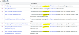

  • Just a comment on how you create then link the EF's through code:
    Your first line creates a new EF on the root level, then you add it to an existing EventFrames collection on line four. If you want to create it directly on the child level, make sure you combine the two operations. I.e. use one of the overload methods of the EventFrames class to create the EF directly. The way you're doing it now first creates it (on the root level), then you add a reference to it on the child level. By creating it directly using the correct overload of Parent.EventFrames.Add(...), it should be created the correct place
  • Thank you! I'd looked at the overloads, particularly the ones that allowed you to pass an AFReferenceType parameter, but hadn't noticed that this or the others create a new Event Frame!
