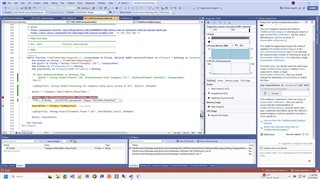

I am trying to use AFElementSearch in the AF SDK and I used the Search feature from the PI System Explore to create my query string, but I am getting a "Type required" error at runtime. Below are the details. Any help would be appreciated.

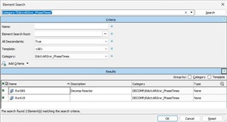

Here is my search from PI System Explorer
Here is the source code. The AFDB object has a valid AF database object defined. I have commented out some of the original code and hard coded the query string just for testing purposes.

Here is a screen shot of the error:

  • Thank you for your response not sure why my screen shot images did not stay in the original post. I will try again in this response. Please see below. If they do not show up, please let me know.
    As for your comment regarding the search string needing to specify either an element template or a name or pattern, not sure why that is needed. I am looking for all elements with a specific category defined. I may have some scenarios where I am only interested in any descendants under a root element. I am attempting to use the element search under PI System Explorer to build up my search string. I will make the change as you suggest for the variable Search Elements

  • Thank you for your assistance with this issue. I did make the change you suggested without setting the object type. From the debugger it returned the same error as it did before which is error BC30182: Type expected. "Category:""Edict:ARSrxr_PhaseTimes"" Root:""HSC\%DCC\0160""" .

    I am still wondering why it is generating an error regarding the query string. I would think I should be able to use the same query string from PI System Explorer Search --> Element Search in this code without any errors.
  • OK, I was able to resolve this. Turns out the message returned on the AFElementSearch object of error BC30182: Type expected. "Category:""Edict:ARSrxr_PhaseTimes"" Root:""HSC\%DCC\0160""" appears to be a bit of a red herring. Once I changed Dim SearchElmts As IEnumerable(Of AFElement) to Dim SearchElmts As List(Of AFElement) and then used SearchElmts = ElmtQry.FindObjects().ToList() everything worked fine. Thank you for your help!
