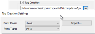

I've noticed that when mapping an output from an Analysis to a new attritbute, the tag that is created defaults to ptclassname of "base". When this happens, we lose traceability of who created the analysis. Is there a way to force it ptclassname of "classic"?
I've managed to this once, but can't recall the steps that led me to it.

  • I assume you are using the "Tag Creation" option for attributes. Just make sure you choose classic instead of base.
  • No I haven't but have seen that dialog box with that option. Is it only available when creating a new attribute template? Also I assume I would have to create the attribute with its parameters/settings before mapping the output of the analysis. Is that the correct sequence?

    Also, if you do not want analysis to create points (maybe the quick resolution here) and want users to create the points you could solve this problem by unchecking the box below:
    You can find it from the PI System Explorer>Management tab at the bottom>right click in the operations area on the right side>Edit Analysis Service Configuration.

    I will try the quick fix. For now, I've also asked users to first create an attribute instead and then map the output of the analysis to it, as opposed to the analysis service creating and mapping to an attribute.
