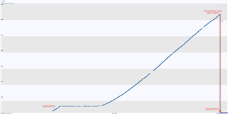

There is an option in the PI System Management Tools --> Archive Editor to edit logged points from the past. I need to edit a lot of points, so this would take forever. Is there another option e.g. with the Excel Add-Ins PI DataLink and PI Builder?
We have energy meters that are visualised on WinCC. Until recently, these energy meters were displayed in kWh, but now the supplier has changed the unit to MWh in WinCC. As all future values will now be logged as MWh, I would like to divide the points logged in kWh by 1000 so that we have a consistent curve over the entire logging period. As we have 10 energy meters, some of which have over 70,000 logged points, the methods I know would take far too long to correct this deviation.
