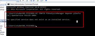

hello,
I want to ensure that pi buffer subsystem starts first on machine start. I have an issue.
I am following what's says in the documentation but I got an error :
Can someone advice?
Thank you,
hello,
Can someone advice?
Thank you,
Does the 'PI Analysis Service' exist? The command looks correct to me!
