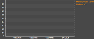

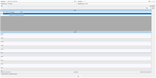

The custom data reference works as I expect and need it to. The issue comes in PI Vision when it loses functionality. In PI AF the value will output '1000m3' but in PI Vision it shows 'No Data'. Furthermore, when you hit 'Trend' or 'Time Series Data' in PI AF, it will display the data.
I believe the issue in PI Vision stems from the fact that it is essentially trying to look at the value "right now". But since there are only values at 2025-04-01 12:00:00AM and 2025-05-01 12:00:00AM it causes a "No Data" error. My solution to this was to change the timeframe in PI Vision from 8h to 1mo to include the period at which there is a data point. However, this results in the same "No Data" error.

-Error in PI Vision
-'Time Series Data' in PI AF
