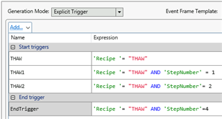

Multiple Trigger Event Frames. I realized that the event frame THAW1 and THAW2 trigger do not generate. Is it because of the "AND" Statement? I see events when I have only one statement. I need both statements to be true.

  • Please add some more information. It would get good to see the values at evaluation, whether it is event-triggered or periodic, any 'true for'. Severity levels could impact this too I think.
    If Recipe = "Thaw" and StepNumber = 2
    I'd expect:
    THAW | True
    THAW1 | False
    THAW2 | True
    So two event frames would get created. THAW and THAW2
    Is this different from what you experience? An 'AND' statement requires both (all) portions of the expression to resolve to true.
