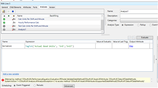

Hello,
I am getting an error when trying to use the function TagTot. From the screenshot attached, when Variable1 is added along with the Expression, the following error is returned after clicking on Evaluate.
Attempt by method 'OSIsoft.AN.PerformanceEquation.Evaluation.PENode.ValidateDataMethod(OSIsoft.AF.Asset.AFAttribute, OSIsoft.AF.Data.AFDataMethods, System.Action`1<OSIsoft.AF.Analysis.AFAnalysisException>)' to access method 'OSIsoft.AF.Asset.AFAttribute.IsSupportedDataMethod(OSIsoft.AF.Data.AFDataMethods)' failed.

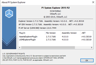

This is the first time that I am trying to use the TagTot in a Analyses. Any support on this error message would be greatly appreciated. I've also included a screenshot with the PI AF version.

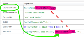

    I'm not going to delete this preceding comment because it could be informative to some, but I think I actually identified the problem. It looks like you're using your tag value for 'Shift Start Time' in the Variable1 expression, but I think you want to use the calculated evaluation of Variable1 (ShiftStartTime).
    Look here:
    Notice the distinct lack of ' ' around ShiftStartTime? That's because it's using the variable evaluation, instead of your 'Shift Start Time' tag
    Hope that helps!

  • I'd like to add that the versions you're using for AF Server and Client has some serious known bugs to it, so I would really recommend upgrading to a newer version, at least you should see something with 2018 on it.
    We were doing an AF refurbish project for a client back in 2018, and beacuse of their IT policy they didn't plan on upgrading from 2015 anytime soon. Eventually, I had to make an ultimatum that we'd not be doing any AF work for this customer unless they upgraded to at least 2016 R2. In 2015, I'd constantly lose data, it happened multiple times that my last 2-3 hours of work just disappeared - even if I had checked my changes in. So please, do yourself a favor and get something newer.

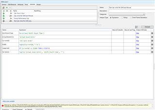

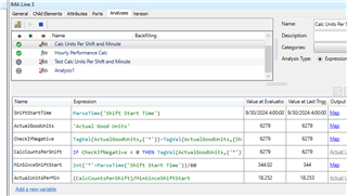

  • Thank you, everyone. I created an new Analyses and I still get the same error, and as it can be seen on the second screenshot below, the tag Actual Good Units return good value on a different Analyses. I believe that our version of AF does not have support for this function, maybe ?
  • Did you try a configuration with my recommendation where you use the variable 'ShiftStartTime' (your variable 1) instead of the tag value 'Shift Start Time' that I think I see in Var3, maybe Var4, and Var5?
    Looks like the error relates to OSIsoft.AF.Asset.AFAttribute.IsSupportedDataMethod so I'd think that means related to the data method of the the calculation on either a tag being calculated (current state) vs a variable AF attribute (what would be used if you swap to 'ShiftStartTime' ) being calculated.
