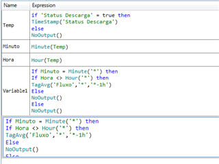

Hey guys. Can someone explain to me if it is possible to calculate, in AF Analysis, for example the hourly average based on the timestamp of a given input?
Exemple: I need to calculate the hourly avg flow based on the timestamp of a given input. Like a TAG that indicate the start of a operation.
My triggers:
Start time: 7:34 am
End time: 8:39 pm
The result should be the hourly average at 7:34 am until 8:34 am .... 7:34 pm until 8:34 pm
