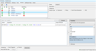

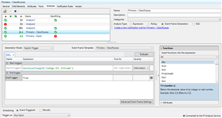

I have an event frame to capture every value every time that 'Codigo GTL Entrada' changes.
But I would like an attribute called (Confirmação Descarga) Discharge Confirmation to be updated even if the event is closed. Because it can happen that the value of the (Codigo GTL Saída) Output GTL Code is obtained after the event is closed.
And I need this (Confirmação Descarga) Discharge confirmation value to be updated in the (Primario - Classificacao) Primary - Classification event.
This condition in Analysis3 is working as expected.
