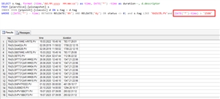

I also tried this query, but I also get duration times below the desired (1500) and I can't adjust that.
Thanks Jinmo,
that should be OK. I corrected it a little and put AND status <> 0 because it also took values earlier than 1500d
