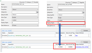

Good morning everyone,
I would like to have the Dens variable with 5 decimal places. As seen in the attached picture, there shows the 4 decimal places (1.4298).
Does anyone know how to solve this problem?
Thanks in advance.
Thanks in advance.
It seems that the decimal place depends on the Display Digits designated in the Output Attribute.
If Output Attribute is not defined , then 4 decimal places are shown.
