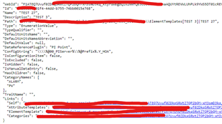

With the PI Web API Help > Attribute > GetByPath method you can obtain the webId and with the PI Web API Help > Point > Get method you can obtain the attributes of the point.
example:
I get webId with TagPI
https://yourServer/piwebapi/attributes?path=\\PIServer\TagPI
get attributes with WebId
https://yourServer/piwebapi/points/webId
