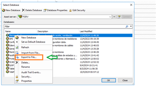

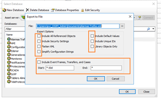

hi team,
I need to update the AF to version 2023.
I understand that it is necessary to make a backup of the bases, but I am not sure about that procedure.
should i export them ?and which option should i select in the checkbox?
Thanks

The manual is referring to a SQL backup.
