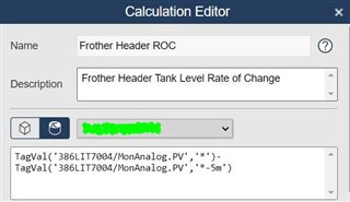

PI Vision Formula
To compare, we have tried the same formula in PI Vision, obtaining the desired result

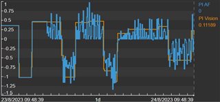

after backfilling, the values obtained in PI AF are similar to those obtained in PI Vision Calculations
