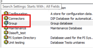

Let's say I have 2 AF databases on the same SQL Server and reachable from the same AF Server,
One which is a functionnal one, describing our process
The second one which is the one connectors use for their configuration and raw output

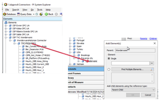

Usually, when we use connectors, we tend to clean up a bit the useful data by cherry-picking what we want to display in the functionnal one, so we mostly rely on the tags that are created
I'm using Wonderware's connector that replicate what's in WW Historian, it is automatically gathered and updated in the Connector AF Database
But as WW is an historian, it carries some functionnal hierarchy that I'd like to keep and not maintain manually so I'd like to reference the created element from the Connectors Database in the functionnal one
Is there a way to do that ?
