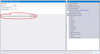

Error: An error occurred while loading the format New Format, Email.

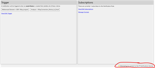

You need to make sure that port 5468 is open between your workstation and the server running the Notifications service. Also make sure Notifications is running, and the server name matches the configuration object (the period for hostname is fine for localhost)
