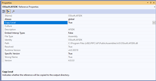

Regardless, the .EXE runs from a network drive, and in that network drive is Osisoft.AFSDK.dll version 2.10.8.440 (this is the version from my developer machine). Installed on his laptop (C:\program files (x86)\pipc\af\publicAssemblies\Osisoft.AFSDK.dll) is version 2.10.8628 - a couple of years older, but still 2.10.

It confuses me a bit, but I assume that it is telling me that for an app run from a network share, it will still look for the local "known" DLL version first, and only look in the current folder later. So I assume it is using his local DLL version.
I can try to get his PI version updated, but I would like to understand the issue rather than just do that.
1.) Why is v2.10 not supporting this AFSearchToken?
2.) How do I force the app to use the local DLL version?
