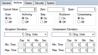

These are the tag settings:

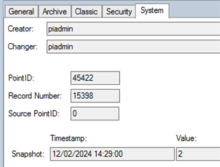

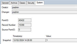

I tried recalculating a few hours and then it gets the correct values for a moment, but at the next trigger it changes again to '2' even when the conditions of the analysis are clearly NOT met. It doesn't makes sense, it shouldn't be a '2'. I thought maybe the snapshot value is not refreshing but just after recalculating the snapshot value changes to '1', and then it's '2' again after a minute. Where this '2' is coming from? It could be a wrong exception/compression settings?
Snapshot value just after recalculating:
A minute after recalculating:
