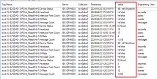

I deleted and recreated those tags, restart interface services without success.

I found my problem!
I have a redundant Interface.
In the Failover there are UFO Tags.
I needed to create both DeviceStatus1 and DeviceStatus2 UFO Tags.
After creating both and restarting the Interface now its working
