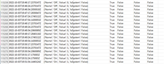

Is it possible to request the average of a PI signal that contains On/Off or 0/1 values? I tried the traditional method but PI returns an error because the place contains a string instead of a numeric value.
