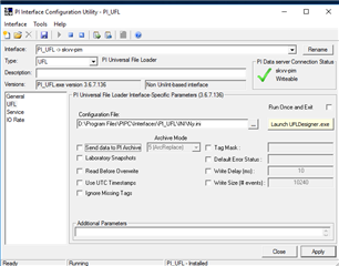

I dont have any of the checkboxes ticked to skip the snapshot:

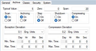

The point is configured to have exception and compression:

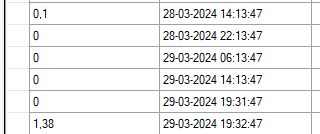

But a value of 0 is still saved each minute, same as the raw data:
it is normally working:
