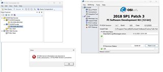

I m trying to connect to Pi oledb using Pi sql commander but im taking the following error:
`Version information not returned in pisdk_subsysquery. [-10734]
Any help on that?
Any help on that?

The screenshot you share indicates your PI System is a Factory Talk Historian which has PI embedded. I recall that the Factory Talk Historian license has some restrictions. Please contact the Rockwell support.
